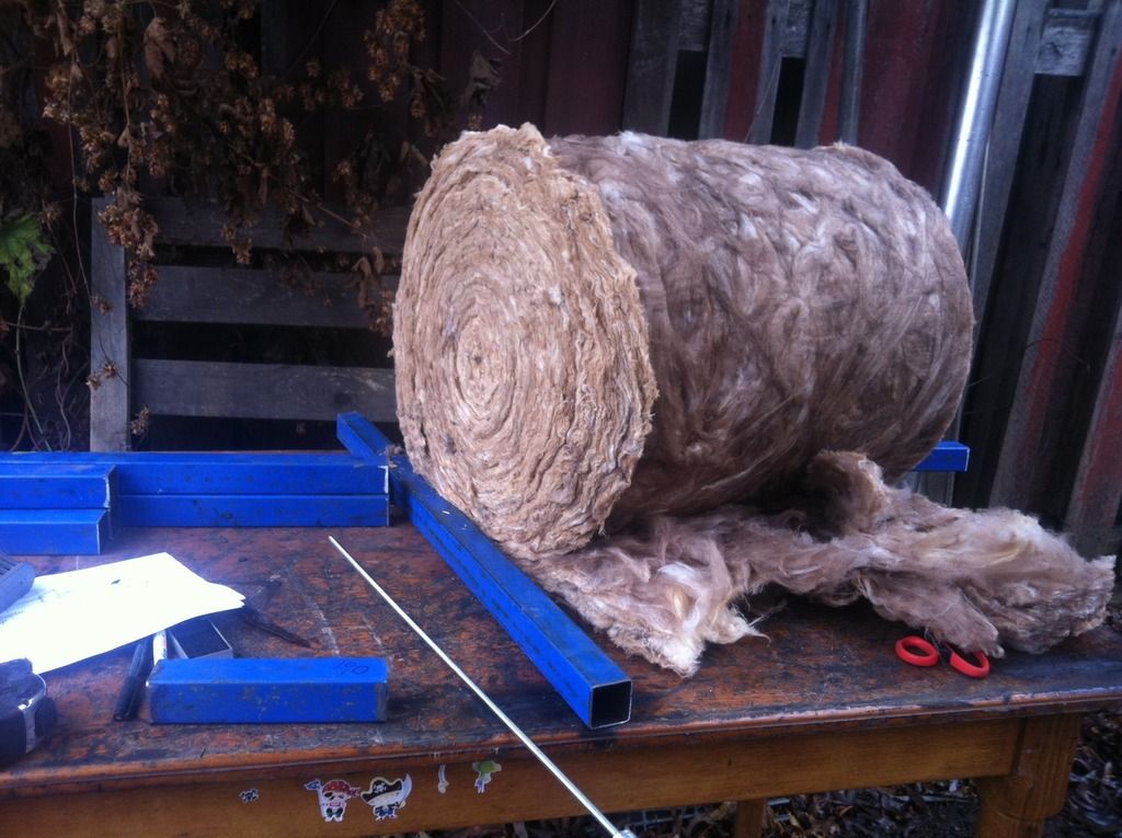

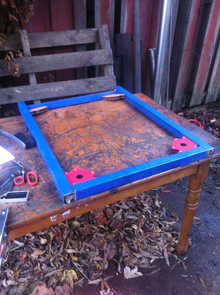

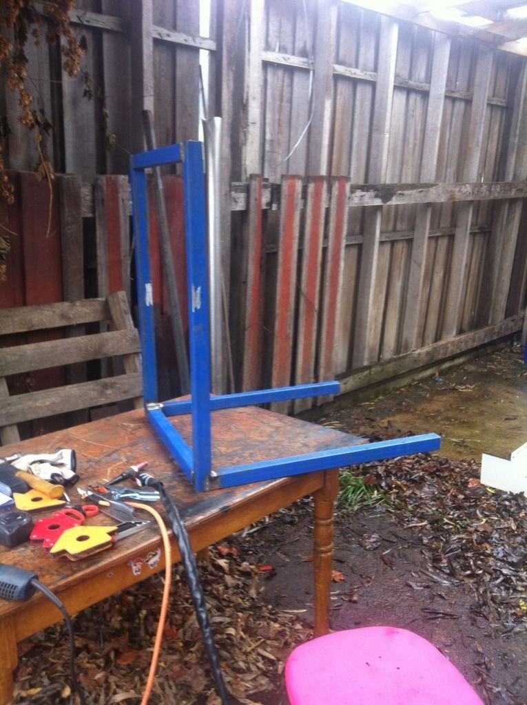

I cut & stuffed some of the frame. I ran out of material as I made a stand for a mate & when he pays me I can get some more.
Then I welded it together
This is all I got done on the frame.

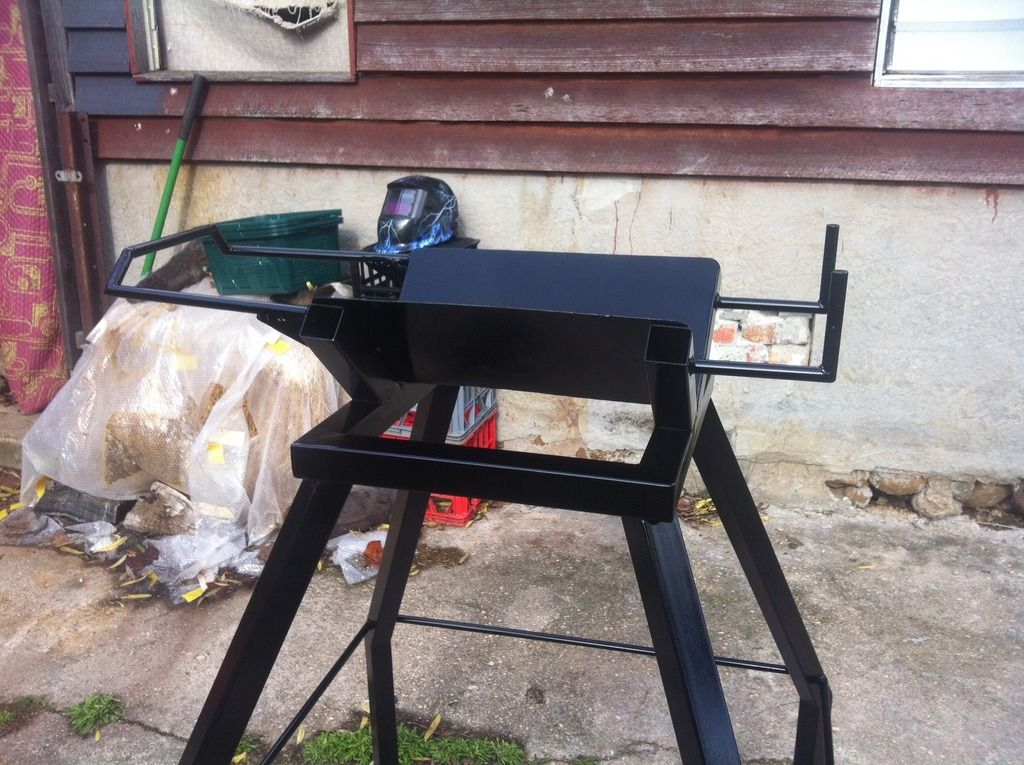

This is the frame I made for my mate, it's to hold his forge, he makes custom knives in his spare time.

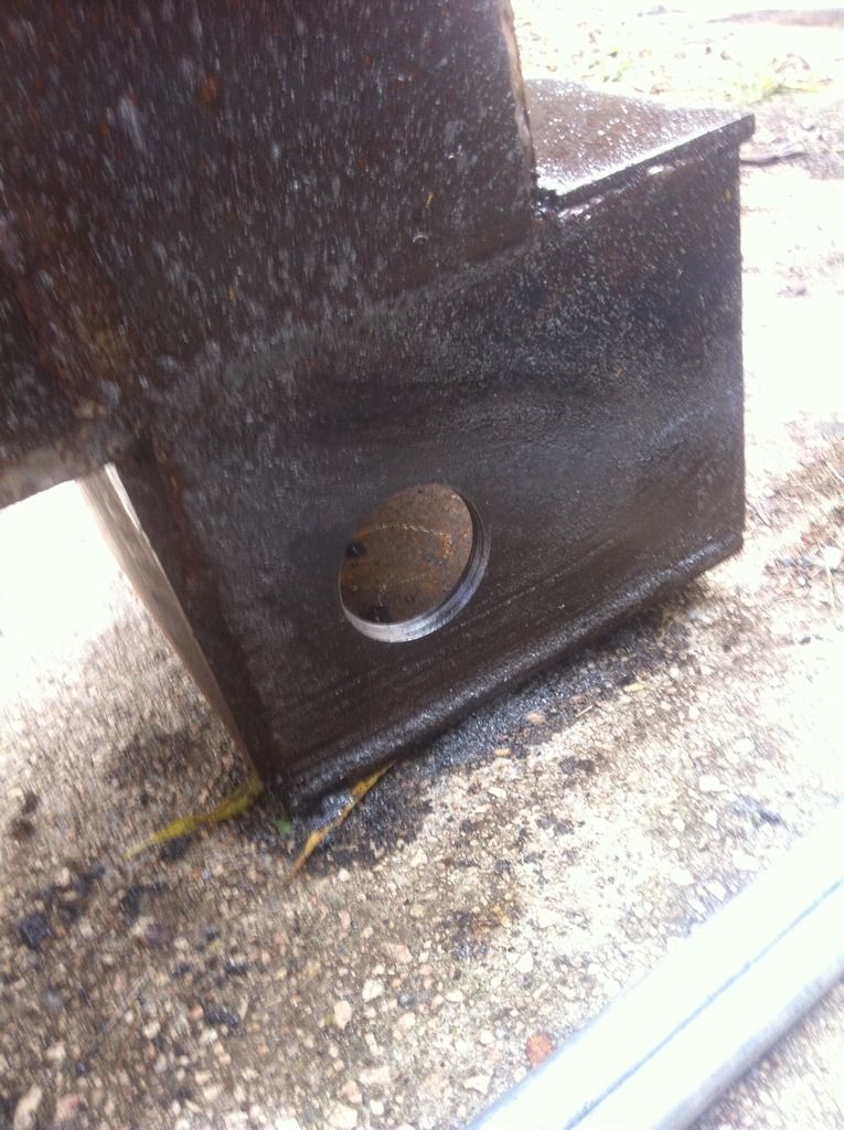

I drilled the hole for the intake as well(almost blew up my drill, lucky it's only a cheap crappy one, lol)

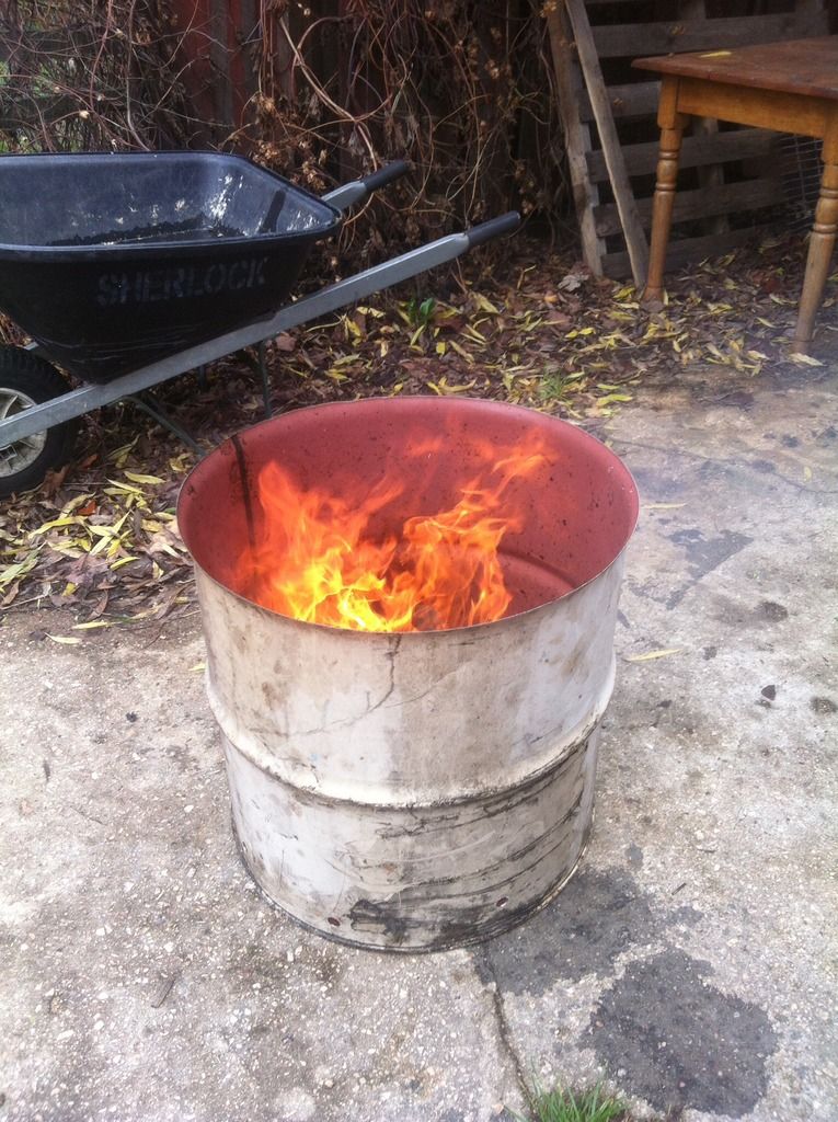

& on an unrelated job which I will start another thread for, I started to make a charcoal retort kiln today & here a pic of the burn out of the bottom section(bonus was it kept me warm while I was working as its starting to get cold :hissy:)

Post by Squiggle » May 12th, 2016, 3:38 am
It was just some old 1/2" square rod I had lying around, it used to be a gate for the sheep. It's the same stuff I used as the guides for the grate. :beer:

Post by Dirtytires » May 12th, 2016, 8:18 pm
too late to stop now. You are committed to continue.
I'd empty the water from the wheelbarrow first tho.....otherwise you're gonna loose quality smoking time to patch up the rust-thru!

Post by Dirtytires » May 12th, 2016, 8:22 pm
On a serious note.....I assume the blue coating on the tubing is for rust prevention. Is this standard on all your steel? Who does it? Do you remove it before welding?
I ask as my steel is oiled and I've never seen blue.
