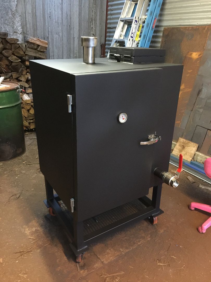

Holey moley that's pretty flash. I was thinking of just an L shaped piece welded on the top of the door. I think you are just showing off now... :-)

ajfoxy wrote:Holey moley that's pretty flash. I was thinking of just an L shaped piece welded on the top of the door. I think you are just showing off now... :-)
Hahaha, I'm a bit like RC, I always make it way better than it needs to be only I didn't make it out of 1/2 inch plate. =))

Is it just me or is that short and fat....which is like me....?
Re: Finally pulled the trigger!
Post by Squiggle » August 26th, 2016, 1:55 am
The Czar wrote:Is it just me or is that short and fat....which is like me....?
Ummmmm, are you talking about me or the smoker?? :-s The smoker is a bit taller than normal but I'm pretty much like you, lol. :D

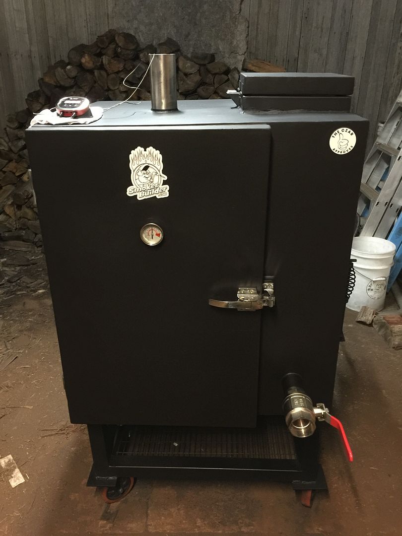

What's the "top" you have on your smoke stack? Looks interesting

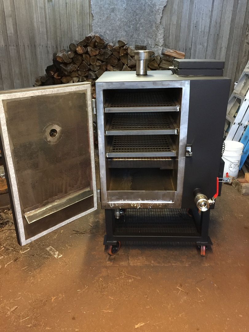

So as promised, here's the rest of the pics. :kewl:

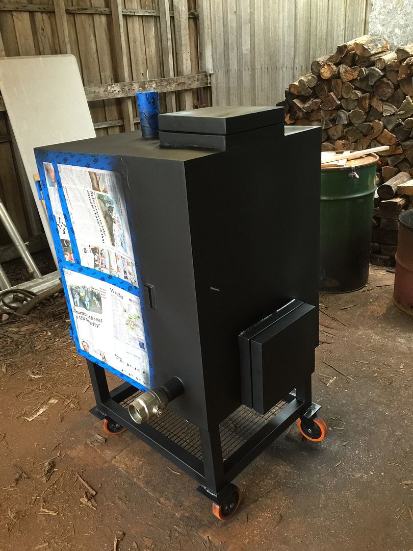

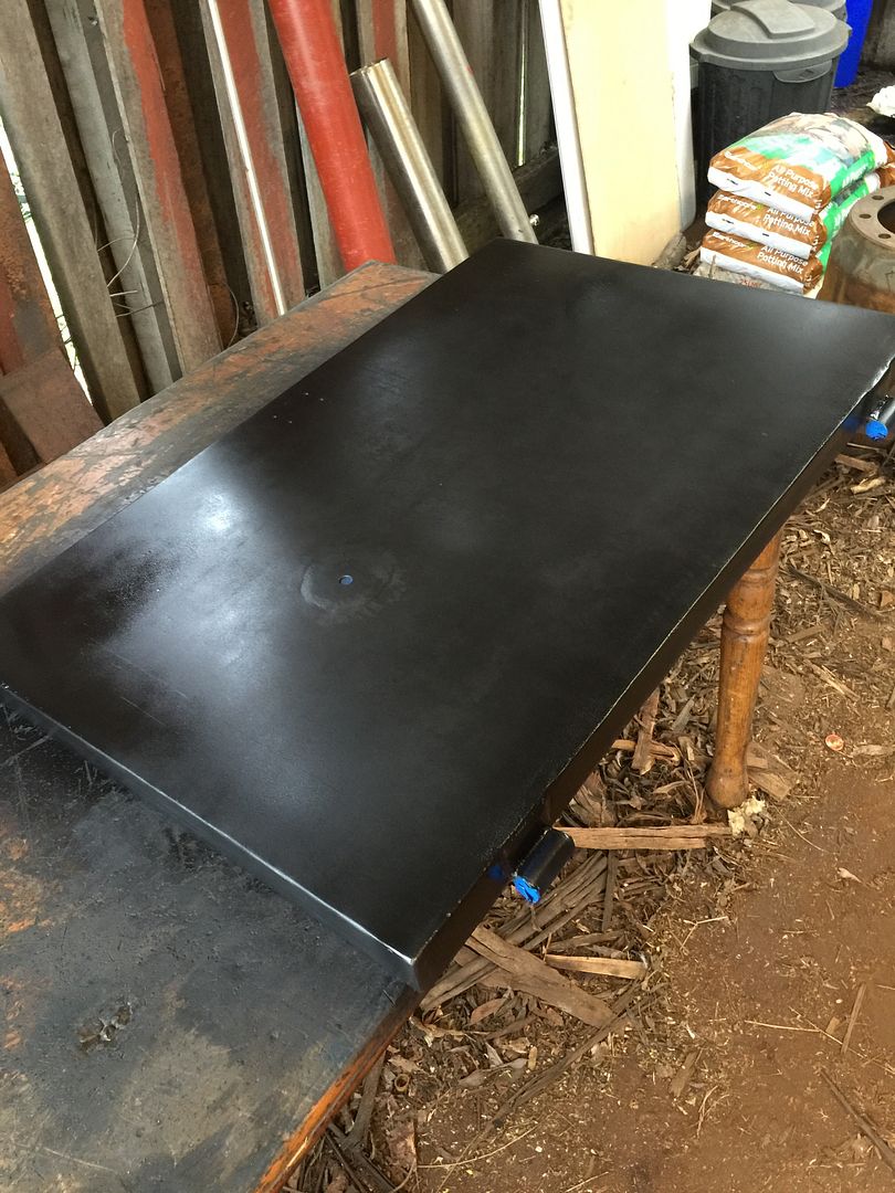

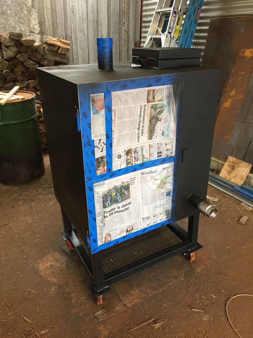

All masked up & first coat on. I used matte black engine paint, rated to 600C.
I can take the door off so I painted it on the bench.

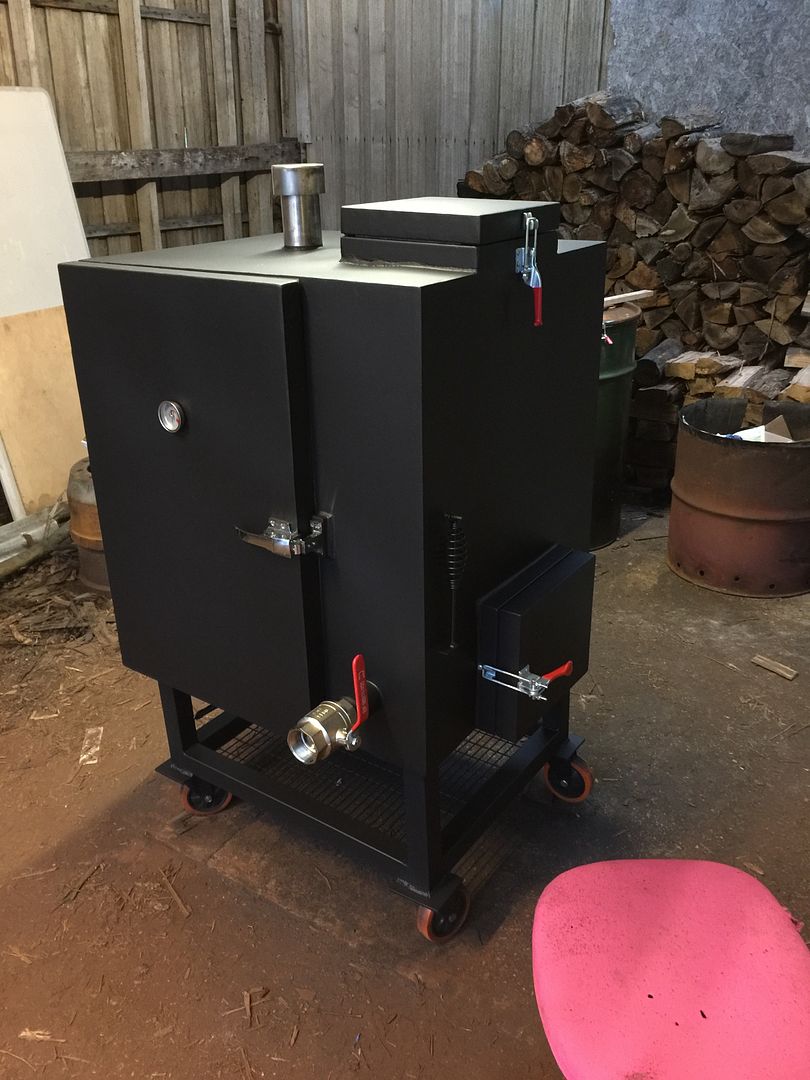

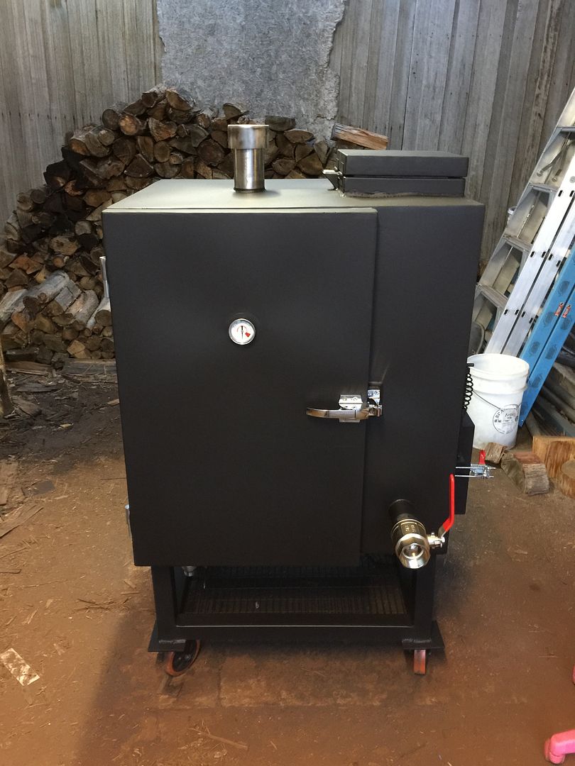

& this is the final product after refitting all the accessories, just two more things to add & it's done. :beer:
The seal finally turned up thanks to Island Outdoor, the original seal I ordered two months ago never turned up :hissy: so I ordered a Nomex kit(15ft long) & I had about 2in to spare.
I don't like the slide top from the plan so I made a removable top to slide over the stack when not in use to keep any rain & uninvited guests out. :D
The smoker will also work with the cap on, only as a last resort when it's raining while cooking. :kewl:

You did a great job on the cooker, no question! I especially like the fact you adjusted areas of the design to suit yourself and not compromise the function. You are a SmokerBuilder. So what you going to build next?

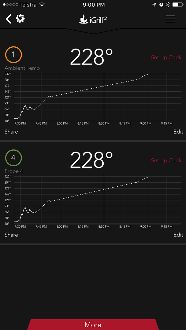

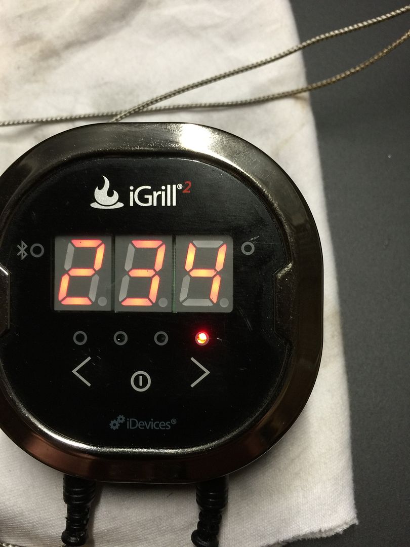

Well I got to fire it up tonight & it was unsurprisingly slow to get up to temp(can't wait to hook up a digi-Q to sort that out). I'm still trying to figure the sweet spot on the valve out, but wide open for 2hrs got it up to 234C(about 450F). Now I'm just trying to find where the valve needs to be for the temp to sit at 130C(about 275F). :wsm:
Best thing is that it has a consistent temp from top to bottom. :kewl:
Also, I finally added the last two items I needed to & it's finally finished. :beer:

Hey Squiggle, what brand of matte black engine paint did you use? All those I've looked at are way under 600C.
Bunnings only carries the rattle cans and they only go up to around 300C. So if there's something out there that is available in OZ that is hopefully in a tin so I can spray it (or worst case scenario roller it). That is not a rattle can... I hate rattle cans :-(
Cheers mate... and that unit is looking the goods... really flash.
Post by Squiggle » September 10th, 2016, 7:52 pm
I think it's called Motorspray & you need to go to a paint place to get it. A 500ml tin is about $25 & it just did two coats, I thinned it out 25%. If you're doing a big GF I would suggest two tins to make sure.
There's a place in Yatala called Resine Paint, they will be able to get it for you, or Beenleigh Paint Palace(I think that's the name of it) will be able to as well. :beer:
