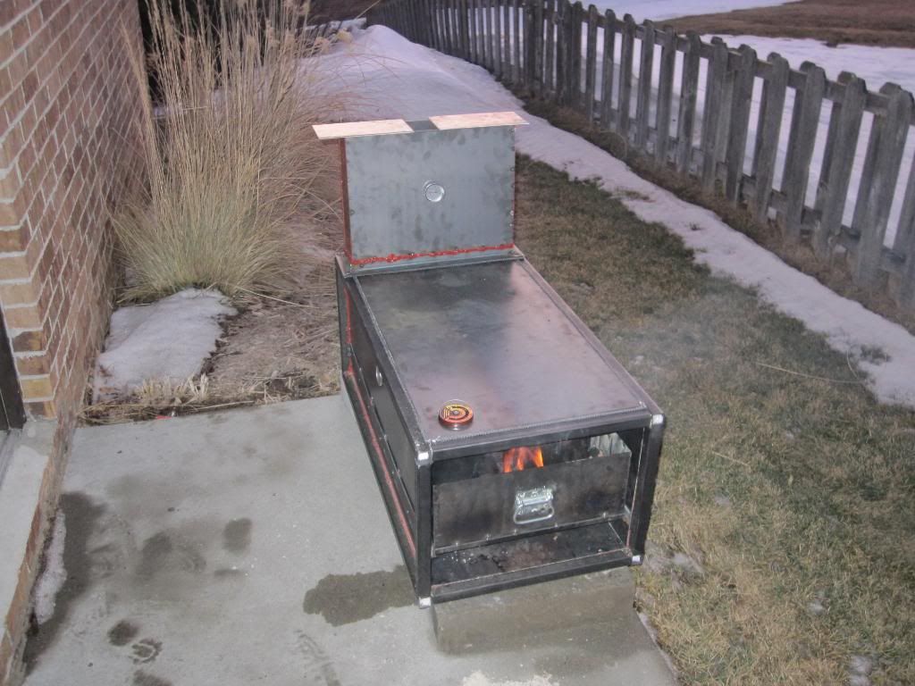

Thought some of you might find these pictures interesting. I just found them on an old camera last night and I thought of all of my other demented smoker builder friends on here so here you go - should be good for laugh... :roll:
Three stages of the maze idea - built - burning - and almost done - total 23hrs and 45 min.
Built a basement cabinet for the maze with 1" thick walls and insulated
basement burning with riser for temp measurements... door's not on in this picture.
Built and upstairs/cook chamber for it... also insulated but 2 inch thick roof.
Inside the cook chamber....
Cooked one load of chicken wings in it one time - then stripped it down for the steel. Didn't work.

what didnt work about it? did it not get hot enough? looks like an interesting idea to me. i think with some minor changes it would be a great little smoker :mrgreen:

After about 3 hours it will flash over (runaway fire) the heat dried out the unlit charcoals and they would spontaneously ignite.

dang...that did look cool as heck...have you played around with this anymore? :huh: :points:

not his one but I think I learned enough to get a smaller version to run in Edgar - stay tuned...

wow thats alot of work just to scrap out :headwall:
