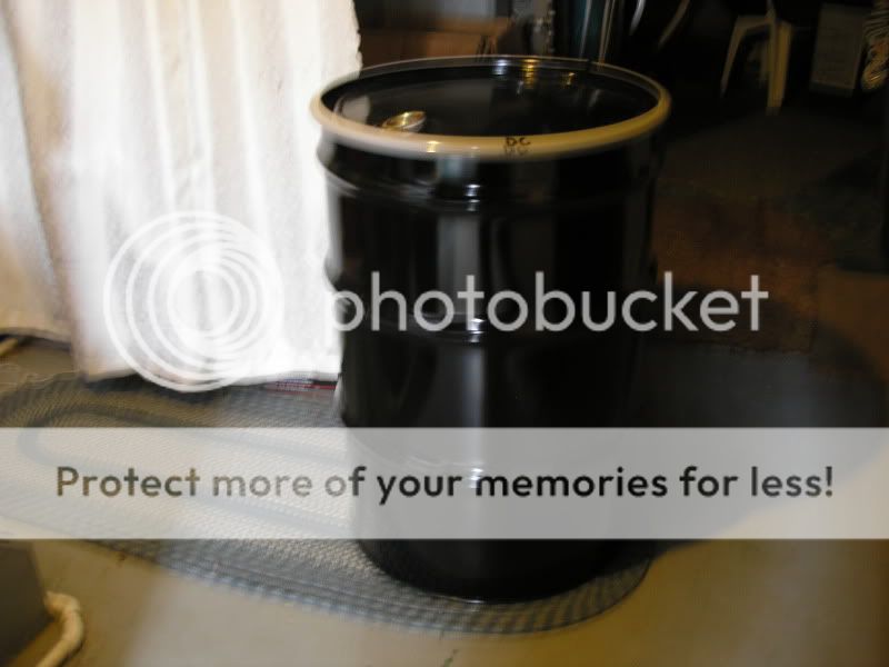

Post by DarylCincy » February 18th, 2012, 7:17 pm
I made my introduction a week or so ago starting with my UDS sugestions and I got some more parts for it and thought I would open a new post about the build.
Pics,
DarylCincy
Gator Pit of Texas
Party Gator 24"x 42"cc 24"x 22"fb
UDS (in the making)

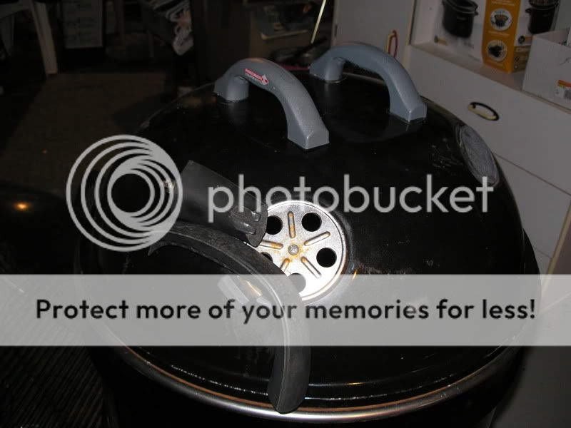

Post by DarylCincy » February 18th, 2012, 7:18 pm
I'm now working on getting the dome lid to fit?

Love the magnet vent covers. In the middle of my first UDS myself. Can't wait to see more. :wsm:
Father of crazy twin boys.
Posts: 7078
Re: My UDS Build, making it simple!
Post by Frank_Cox » February 18th, 2012, 10:29 pm
uh oh, the old magnet trick...
just kiding, looks great! I grind the paint/ enamel off the bottom of the lip of the kettle lid and then stitch weld the kettle lid to the barrel lid. then I cut out the center of the barrel lid leaving the ring of the barrel lid in place. it fits perfect. after I paint the lid I get high temp silicone the same color as my paint or at least use clear color and seal the 2 the rest of the way.
some of the guy's on here use a piece of strap around the inside of the drum also. both will work perty good.

Thanks Frank, Since I got the 1" metal strip and I don't have a welder I may just try the metal strip.

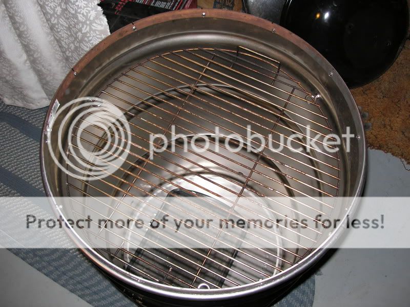

Today I worked on the UDS, I got the lid ring modification done and the cooking grate installed.
pics.
DarylCincy
Gator Pit of Texas
UDS (in the making)
Posts: 7078
Post by Frank_Cox » February 19th, 2012, 7:10 pm
Lookin good buddy! should work great!

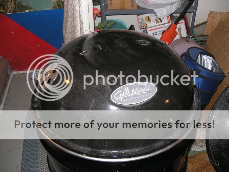

I worked on my UDS today, I made a heat deflector/water pan out of a 14" stainless steel wok and made some handles for the lid, the one was broken that was on it. pics.

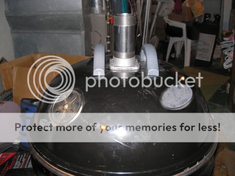

A Mod I did today, I put a 2"x 5" stack on the uds Some may like it some may not? Pic.
Post by Gizmo » February 26th, 2012, 8:05 pm
Qooole! - now screw on a 2 foot extension with a weather cap and a rooster with a weathervane and some North, South, East and West arrows then maybe a lightning rod with a ground wire - damn I like to over-design stuff... :D
sorry - it would prolly take 2 people just to take the lid off... :oopssign:
Post by Smokeone » February 26th, 2012, 8:33 pm
Hey that is a UDS, no need to dress it up! I do like the new handles and exhaust tho!
Looking good! Do you have a plan to adjust the exhaust?

Post by DarylCincy » February 26th, 2012, 8:44 pm
[quote="smokeone"]Hey that is a UDS, no need to dress it up! I do like the new handles and exhaust tho!
Thank's for the comments!
I will more than likly allways run the stack wide open, but I can get another flange just like what its mounted to and screw it on top of the stack with a plate to slide open with one mount bolt.

Gizmo
Posts: 6135
BBQ Comp Team Name: Edna's Kids Comp Team - KCBS Certified Judge
Post by Gizmo » February 26th, 2012, 8:45 pm
That's a great Idea!
Post by Smokeone » February 26th, 2012, 9:00 pm
Thanks DarylCincy!
I usually run my exhaust wide open too.
Was just curios since it is a single large opening, i think that will move alot more air than the standard kettle openings!
Post by DarylCincy » February 26th, 2012, 9:17 pm
smokeone wrote:Thanks DarylCincy!

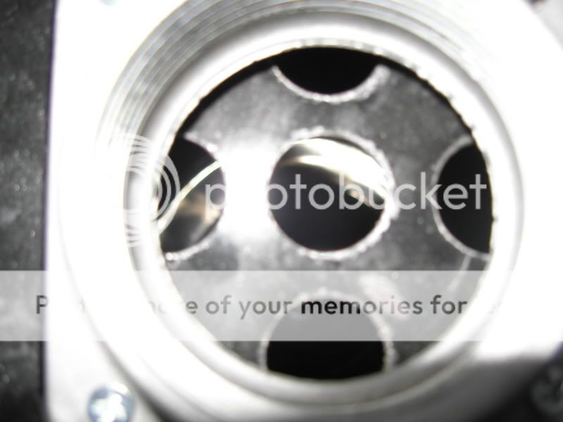

What you cannt see is the stack is mounted over 5 single 3/4" holes kinda a baffle, so its not just a big 2" hole in the lid. It may work better that way?
Post by Smokeone » February 26th, 2012, 9:23 pm
Ah, I get it now! :kewl:

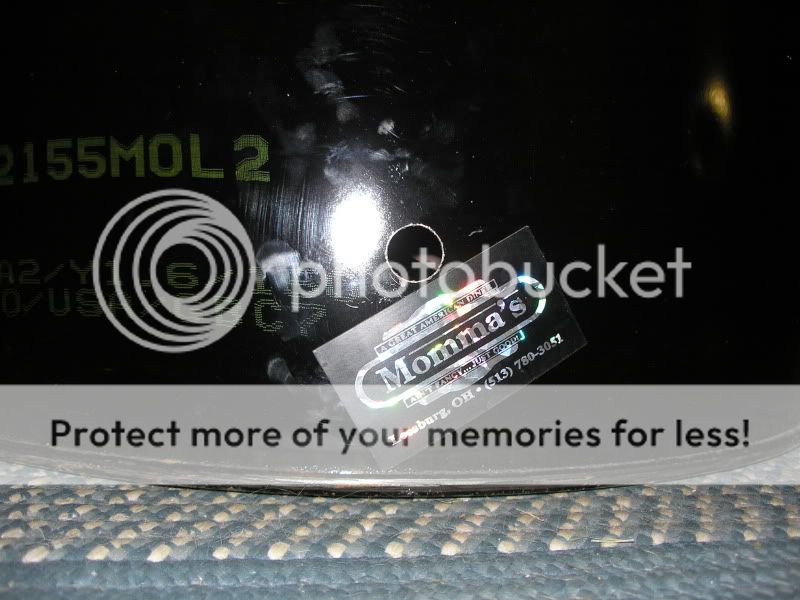

Post by DarylCincy » February 26th, 2012, 9:29 pm
smokeone wrote:Ah, I get it now! :kewl:
This is the pic of the 5 hole baffle under the stack mount.
[imgImage][/img]

Post by DarylCincy » February 26th, 2012, 10:27 pm
KILLSWITCH505 wrote:looks great so far. so whens the first cook?????
Thank's
I need to make some kind of intake vent cover/adjusters I dont care for the refrigerator magnets, I believe they may get hot enought to melt? if not I don't like them much.
First cook? maybe next weekend?

Post by The Czar » February 27th, 2012, 7:47 am
I don't think they get hot enough to melt.....but hey they do work.....it ain't suppose to be pretty you know :rulz:
