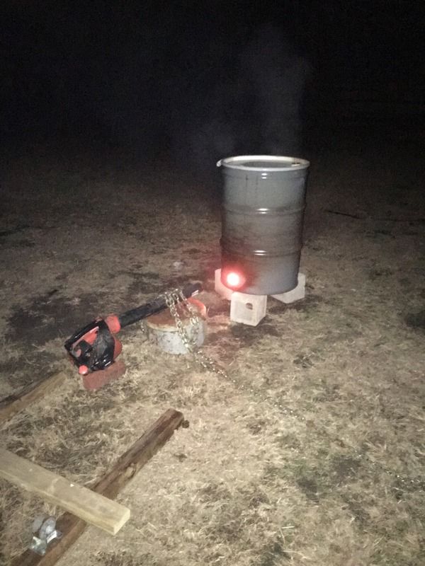

:explode2: starting a UDS build for my wife's god father. He is retiring from the Dallas police department this month. He loves grilling and cooking so I figured I'd throw a UDS with some custom graphics on it together for his retirement party. Burnout is in the process as we speak. Drilled two 1 3/8 intake holes in the bottom and fired it up with some oak. I wanted to burn the lid up to so I removed the bungs and clamped it on tight to hopefully help reduce warping. It wasn't getting quite hot enough so I threw the blower next to an intake and ran it at idle. Got the fire stoked up nice and hot! We'll see how the lid fares.

The lid can be fixed........ I've done several. Each one made franks butt pucker up tighter then a frogs ass in a flood. ( there water tight ) just because each time I did it, we were working with the last lid we had on hand. It's not easy and your flirting with disaster but a warped / taco lid can be resurrected.

Hopefully it doesn't warp but I won't know until tomorrow. I I left it clamped tight so hopefully it won't. If it does I'll just weld flat strap across the top. I already plan on using cam latches to clamp the lid down during cooks.

This drum will be kept as a burn barrel... I've burned it out twice and used a propane grass burner to strip the outside paint. That red paint is still mostly intact on the inside.

Try a little comet household cleaner on it. Most of the time that will do the trick.

I'm shocked tom but that comet somehow got the paint out :kewl:
