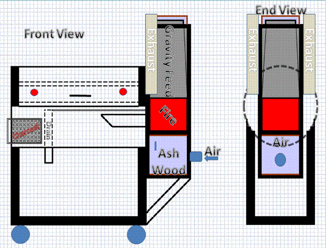

So about how many lbs did it take to fill for the ten hour burn?
Now Listen.....Thats what I say.
One of these days I want to learn to weld real good
I believe that if life gives you lemons, you should make lemonade... And try to find somebody whose life has given them vodka, and have a party
Puff
Posts: 2352
Joined: May 29th, 2013, 11:16 pm
Title: Always All In !
Location: New Jersey...Southern New Jersey
Re: Gravity feed reverse flow
Postby Puff » December 30th, 2014, 9:39 pm
If I may take a guess....about 45 lbs to fill the chute?
Make no mistake, there ain't no powder in this Puff ! And... I'm not really a crazy person but I play one in real life
T&ERun
Wants to build a smoker
Posts: 26
Joined: June 29th, 2014, 11:06 pm
Postby T&ERun » December 31st, 2014, 9:33 am
It takes about 3.5 bags (kingsford 20lbs) and about 30 chunks (fist size) of wood to get the initial fire going and to fill the chute about three quarters full. This nets about 10-11 hours. It's an expensive cook to say the least. I've only did it twice now (usually stick burn). I'm going to try to add a baffle plate in the chute to make it more narrow. The way it is now, I run the chimney damper wide open and the FB intakes about 1/3 open. With a smaller fire, I'm guessing I'll have to run it a little hotter. I may not get the 10 hour burn time. We'll see. I am going to try to see how it burns with just using wood chucks and no charcoal. I'll post results when I do it. Maybe awhile though.

I just posted for feed back on another forum.
I have a 20 x 36 tank that I am wanting to experiment with.
How do you like the almost no maintenance fire that this offers?
What type of temperatures can you maintain?
I am going to square off my ends and add a small charcoal basket to the opposite end for burgers and steaks.

Hey all - looks like the pictures, and T&E hasn't been around for a while. Did anyone happen to save these picturea locally?
Posts: 4128
Postby Big T » September 13th, 2017, 6:29 am
I don't think anyone has the pictures. A lot of guys were using photo bucket to share pictures and the recently made some changes which removed a lot of pictures from the forum. I remember this build, he built a regular offset RF but on top of the FB he had a square cut out, he made a plate to cover the hole and it had flat nomex gasket and 2 latches to seal it off tight. He built a gravity feed chute and FB with a flange that matched the opening in top of the FB. He could remove the plate and install the GF system or block it off and run it as a regular RF.
